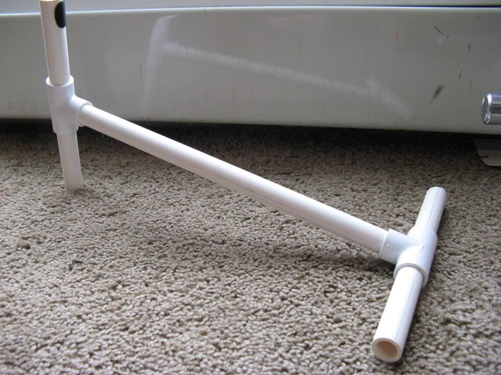

Niddy Noddy
A niddy noddy is how you get your yarn off the bobbin and into a skein. They vary in length (Ashford makes an adjustable one) and are usually wood, but my PVC version is portable, durable, and waterproof!
You will need:
~2 feet of 1/2" PVC pipe
2 PVC T-connectors
Pipe cutter
Velcro (optional)
4 End caps (optional)
Cut 4 short lengths of PVC, 3-4", and one longer piece, 8-14". Put the shorter pieces in the "arms" of the T-connectors and use the longer piece to connect the two T's. Turn the T's perpendicular to each other. Add a small patch of the grabby side of velcro if desired (this makes winding much easier).
The length of your long piece will determine your "wrap length" (the length of one full wrap of yarn around your noddy). I can't really speak as far as cutting your noddy to a specific wrap length as I just cut mine and then measured the length after. To determine your wrap length, take a piece of string and wrap it once around. Measure the length of that string. I wrote my wrap length on the niddy noddy itself so I would remember. All you have to do is count the number of wraps when you're winding and you can use some simple math to figure out your yardage.
This niddy noddy is fully waterproof and can be submerged with a skein of freshly wound yarn. This is useful for preventing tangling during washing. You can add end caps if you'd like to keep the inside of the pipe dry for this part, or just let it air out in between washes if you don't want caps. It also disassembles easily for storage; I've even seen people that have made little drawstring storage bags for it.
