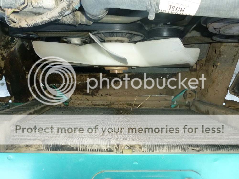

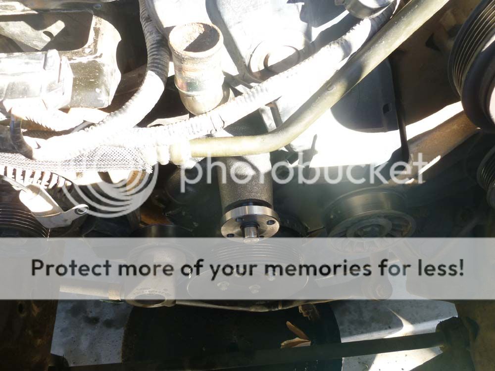

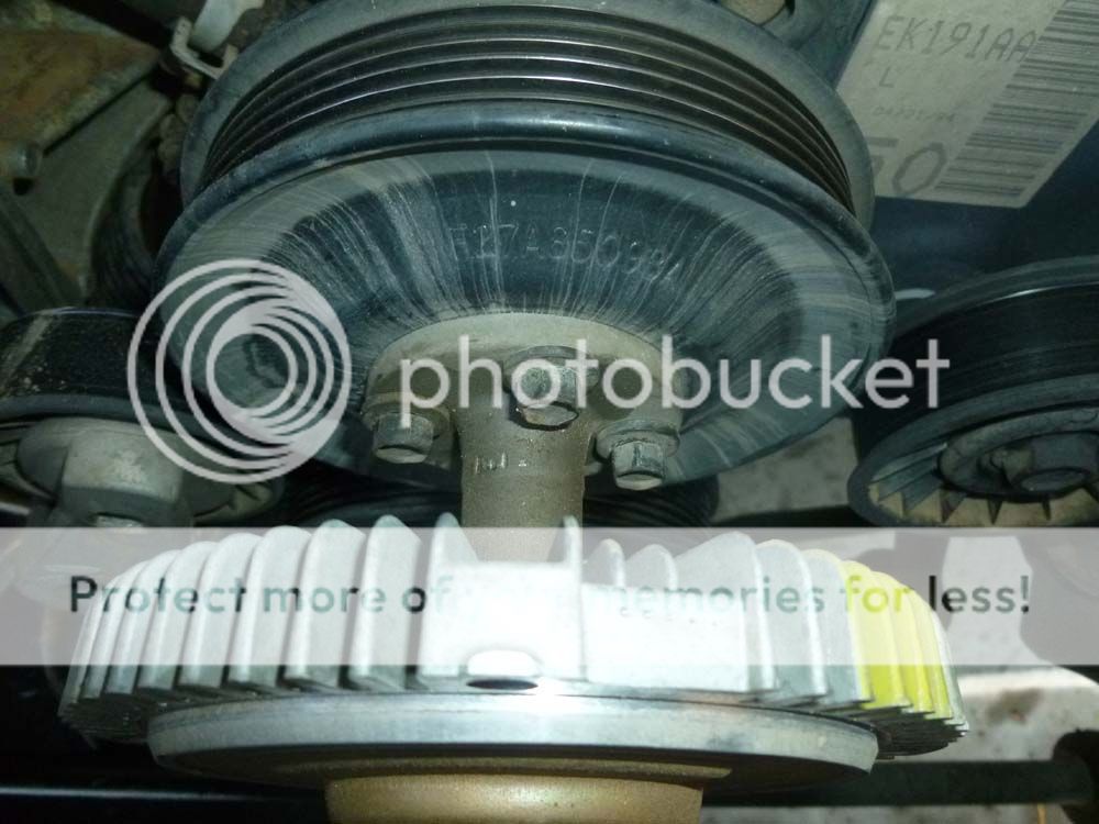

hey NC, quick question. i've heard i need a special tool to get my fan off for when i do the coolant flush/water pump. is that the case with some vehicles?
Re: My journey to maintaining my own vehicles
« Reply #100 on: October 16, 2013, 06:34:27 PM »
Are talking about service wrenches? They are slim and flat making access to cramped places easier.
  • Posts: 5915
« Reply #101 on: October 17, 2013, 07:18:15 AM »
not sure, i don't think it was that... but i could be wrong. i'm going to research it today as i've heard pulling the fan makes life a lot easier for getting to the water pump. someone on a forum said 'special tool' that cost about $15... real specific, i know ::)
the funny thing is, i have everything i need except a $1 gasket for the thermostat. my go to store didn't have one :( hoping it comes in today because the entire job i want to do can't go on without that. i may just run to another store if it doesn't show up.

« Reply #102 on: October 17, 2013, 08:21:29 AM »
I guess he was talking about this maybe?
http://www.northerntool.com/shop/tools/product_200396117_200396117?cm_mmc=Google-pla-_-Auto%20Repair-_-Specialty%20Tools-_-9094133&ci_src=17588969&ci_sku=9094133&gclid=CIWVhduGnroCFaXm7AodknAAHg
I just use a big crescent wrench and smack it with a hammer to bust it loose. Leave all the belts on to hold it in place.
  • Posts: 5915
« Reply #103 on: October 17, 2013, 03:10:06 PM »
that's probably it. hitting things with a hammer sounds like a lot more fun :D

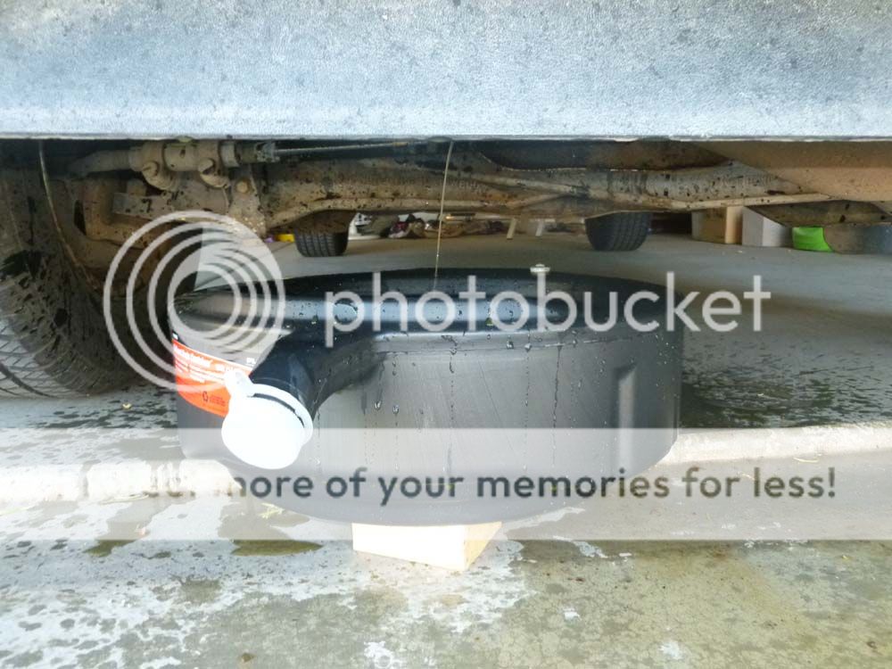

Propped one side up on a 2x4 so I could direct the flow of oil:
Removed the lowest plug to get out as much oil as I could:
Drained as much as I could and then removed another plug on the side so I could get a funnel in to add more gear oil:
Filled it up to the fill level and installed all the plugs. Got everything hooked up, bolted on, and working again and I was back to flavoring coffee!

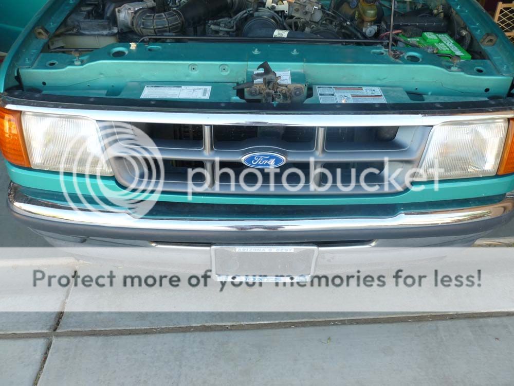

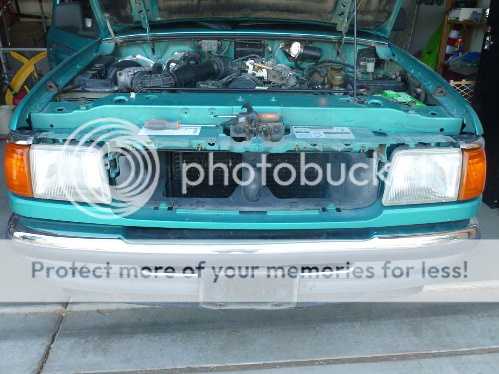

First let’s remove the grill. The write up I saw showed the guy doing this because it allowed you direct access to everything once you get the radiator out. Pretty simple on my truck, all you do is remove several screws along the top trim piece and then a few on the grill.

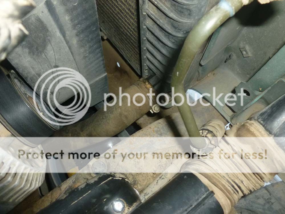

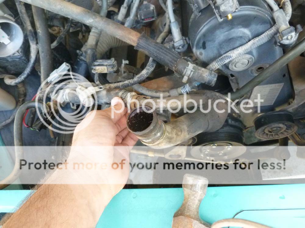

Now we need to disconnect everything to get the radiator out. This picture shows the upper radiator hose and the two screws that are removed to get the fan shroud off:

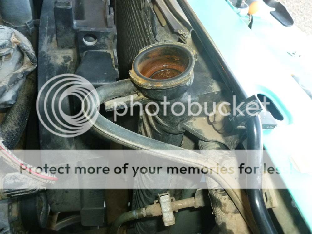

Reservoir line along with the radiator cap (removed):

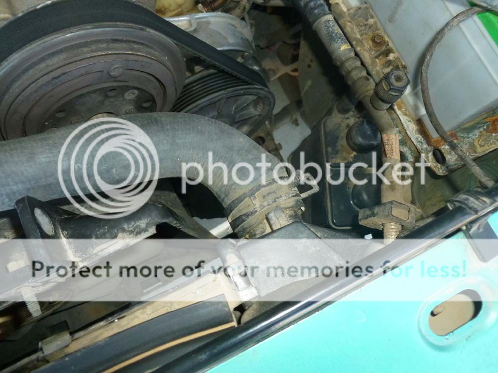

The lower radiator hose:
Note: before you start pulling off hoses make sure you have something to catch all of the fluid. My truck holds just shy of two gallons of coolant.
Both the upper and lower hoses connect with a simple clamp. A pair of pliers gets it right off.

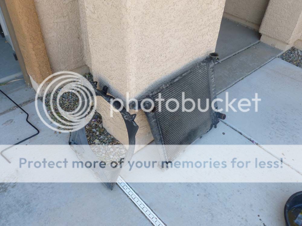

Remember the container I mentioned? Here’s mine… most of the coolant made it, had a little splashing from when it was first disconnected.

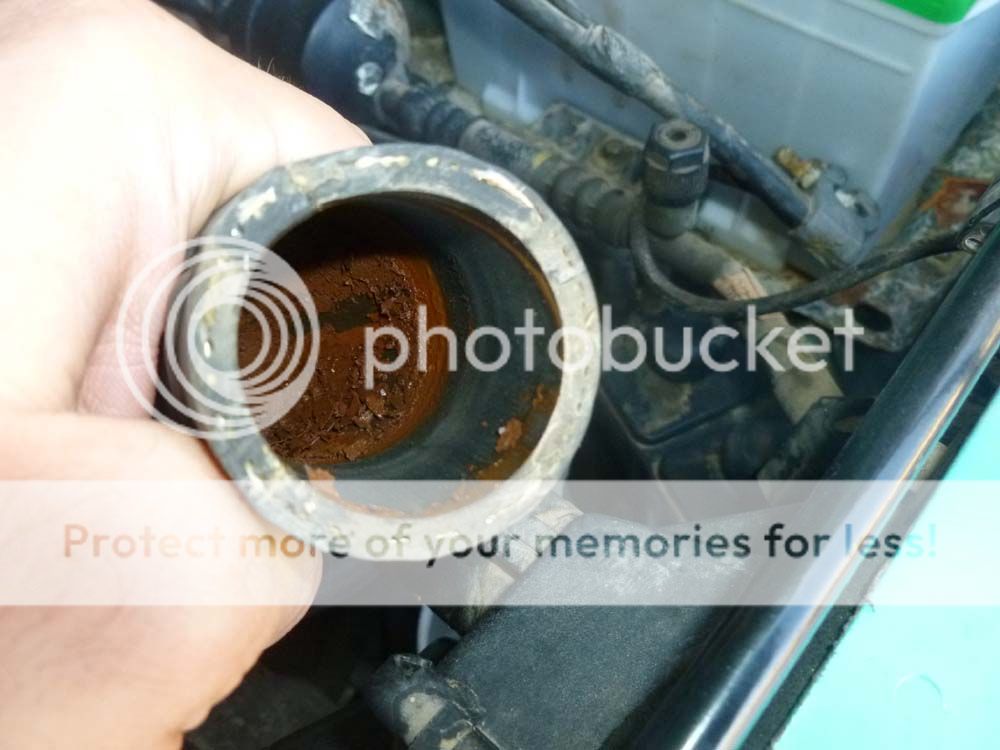

Here’s the inside of one of the tubes. Nasty stuff… I don’t think the coolant was ever flushed, so while the 85k miles isn’t too bad, the 20 years it was sitting in there probably was a little too long…
Don’t forget to remove the reservoir hose as well. Then remove the screws holding the fan shroud in place. That pulls back slightly and then you can get to the screws that hold the radiator in place. There isn’t enough room to get the shroud out without removing the radiator first. Then they both come right out.
And now we have room to work!

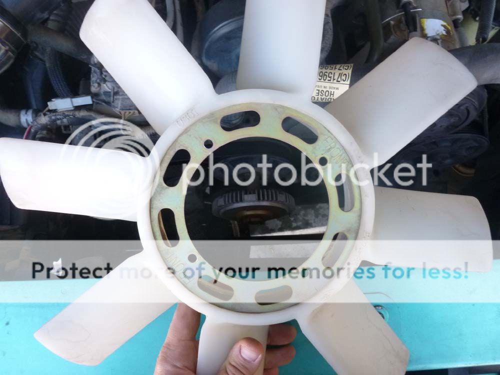

Next to come out is the fan:
Four bolts and it’s off:

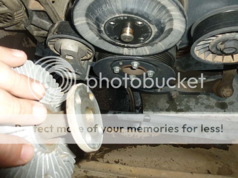

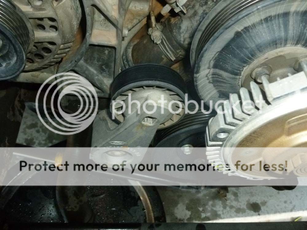

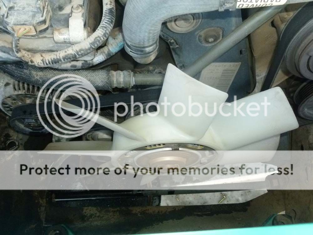

Next is the serpentine belt. There is a belt tensioner that keeps it in place. This is similar to the drain plug on the rear differential. Use a ¾ drive socket in the top hole. Push to the left (lefty loosey) to relive the tension on the belt. This lets you slip the belt off and remove it:
Next are the four bolts holding the fan base into the pulley wheel.

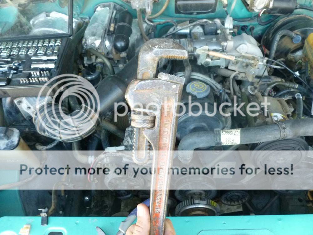

They are pretty tight and if you try to loosen them without holding the pulley it’s akin to loosening lug nuts when the wheel is off the ground, the whole thing will spin. So what do you do? Pipe wrench baby!
Tighten that on there to hold the axis in place while you break the bolts loose, then they come out nicely and the assembly slides right out. The pulley cover does the same:

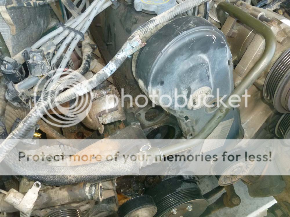

Now to remove the water pump. The timing belt cover is in the way but you can work around it. I held the new pump up so I could get an idea of where the bolts go:

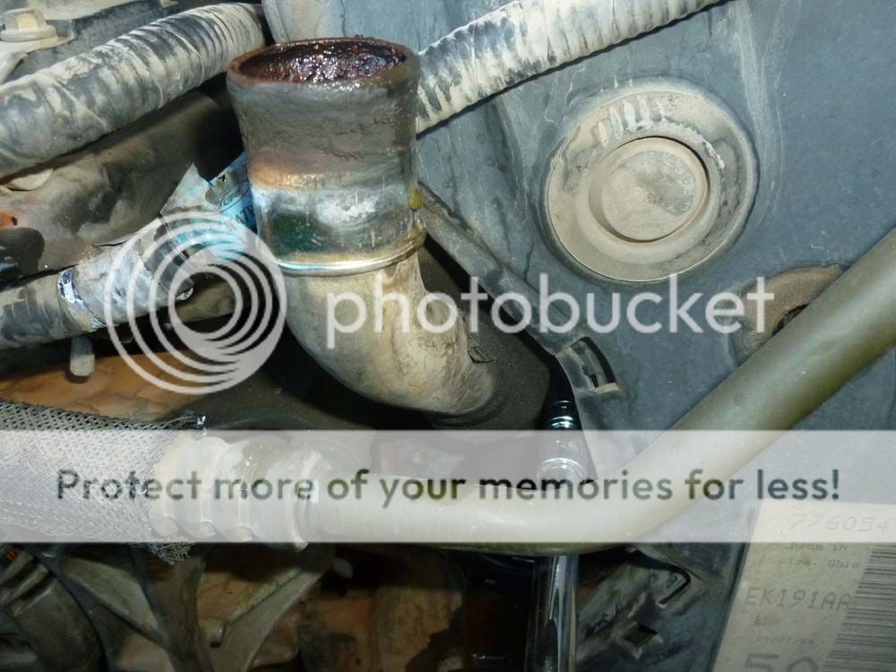

Now that the water pump is out we can remove the thermostat housing to replace that. It is right above the water pump and held in by two bolts:

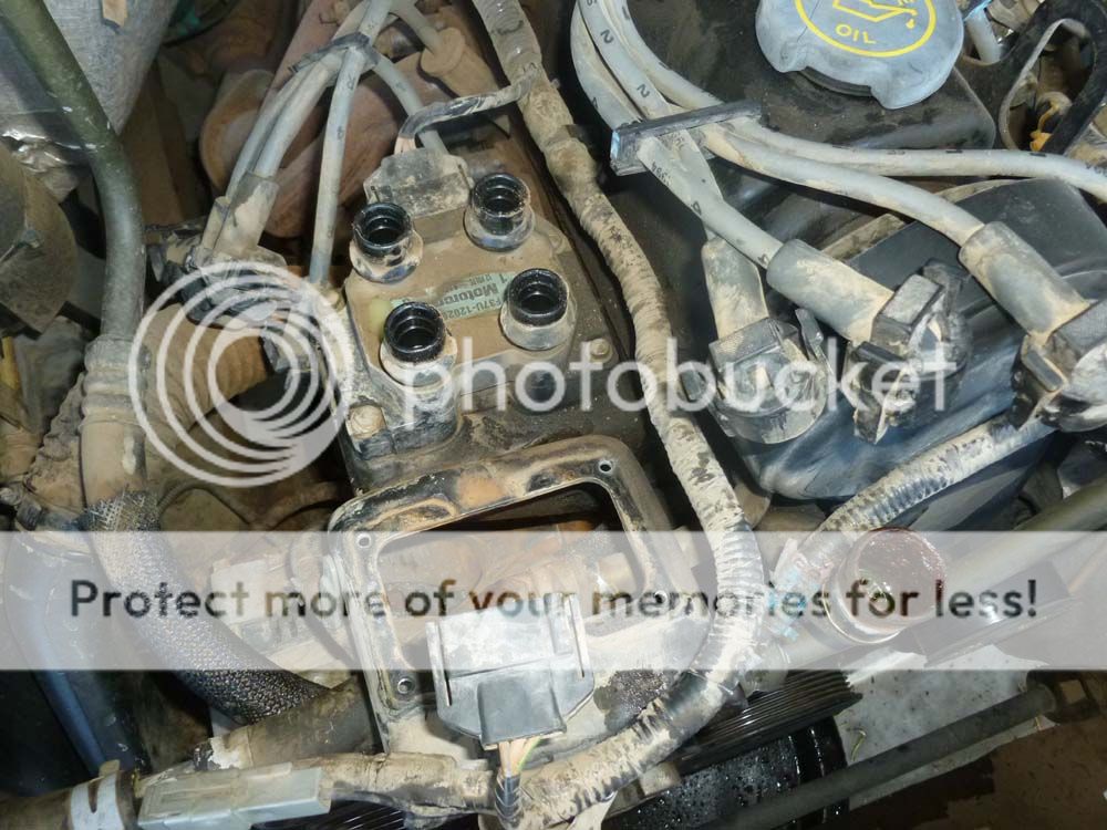

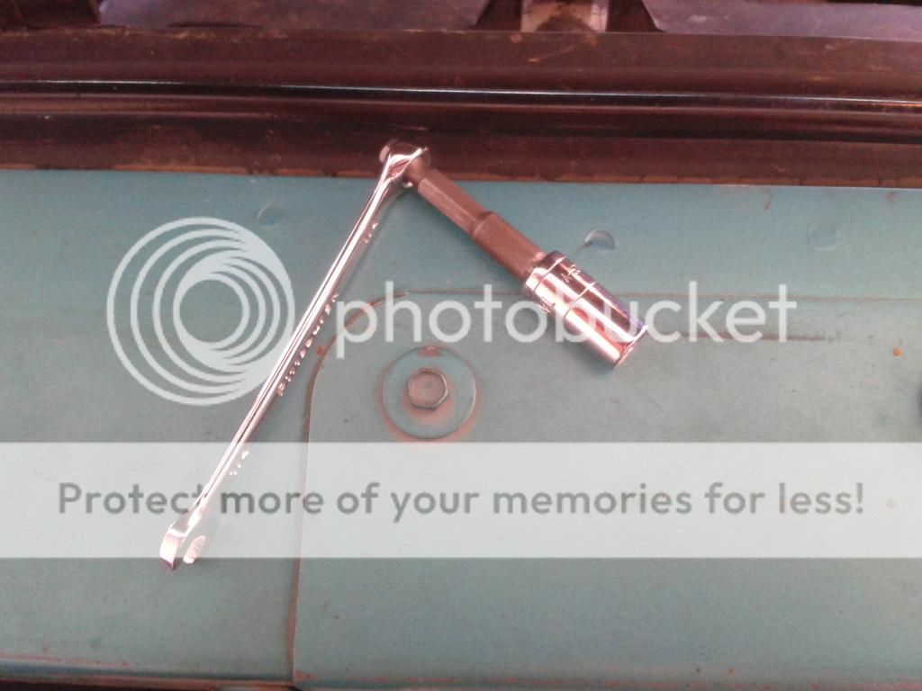

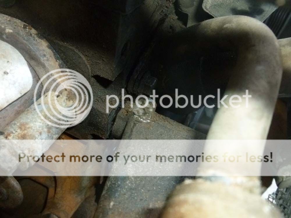

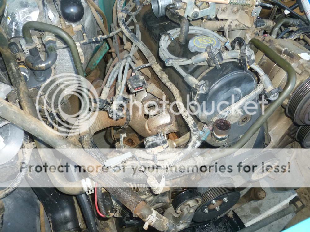

At this point I wanted to set my truck on fire. I couldn’t get the last bolt out. For some reason there was a piece of material on the alternator brace in my way. I don’t know if it was a mess up when it was made or if some sadistic engineer thought it was a good idea to put it there. The fit was too tight to get a socket around and I couldn’t get a wrench in there.

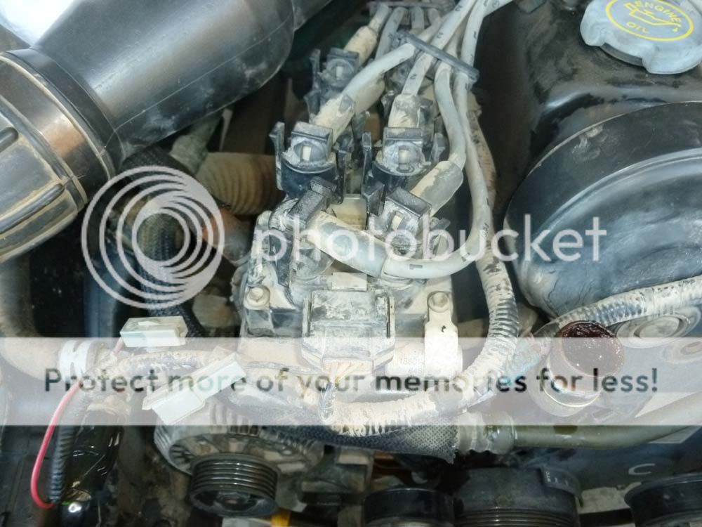

So what did I do to give myself room? I removed both coil packs and their brace in order to get to it… I was not a happy mechanic at this point. Note, since we are removing and unplugging electrical stuff make sure you disconnect your battery!
The wires snap right in so they are easy to remove, note which numbered wire goes where:
Then it’s four bolts to remove the coil pack:
Finally got everything out:
And after about 1000 micro turns with an end wrench the bolt is out and I have the thermostat housing. Victory!

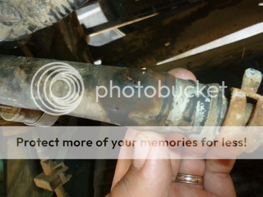

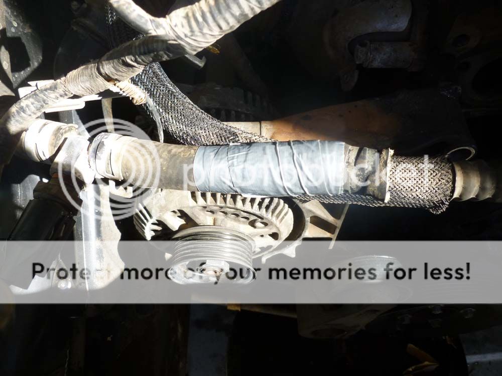

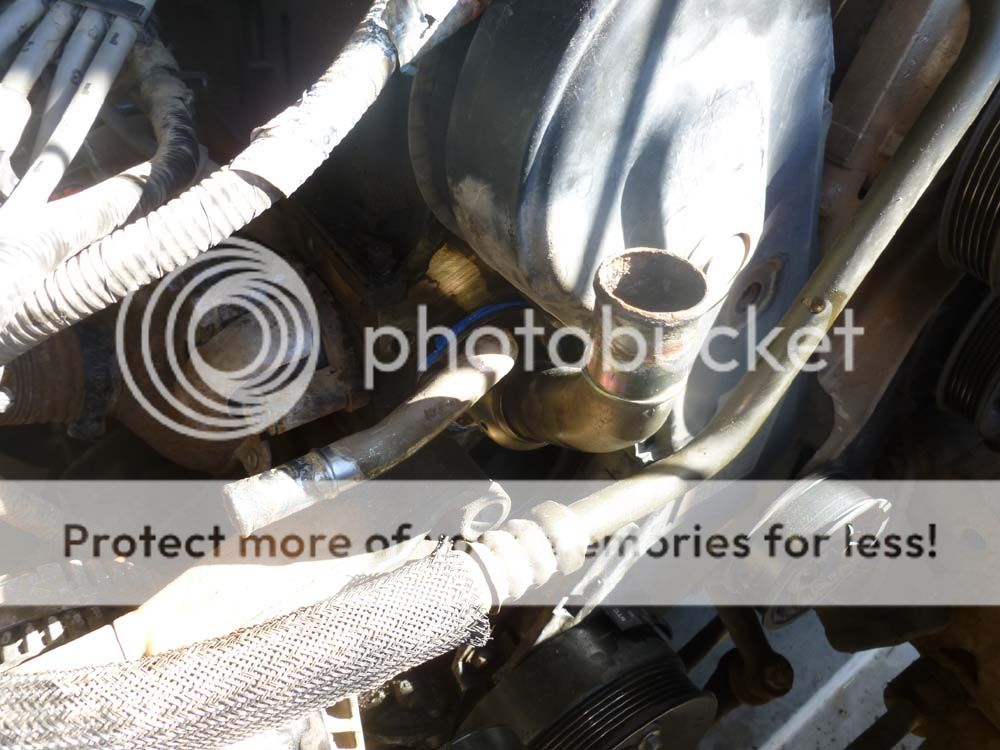

And while checking one of the hoses that connects the thermostat look what I found. The leaky water pump:
Here’s the front of the engine with everything removed:
Time to fix the hose. My wife was at work so I had no means of going to the store and getting a new hose. I had to drive this truck tomorrow… duct tape to the rescue! It’s not on a hot spot so I wrapped the sucker up like an Egyptian mummy and called it good.

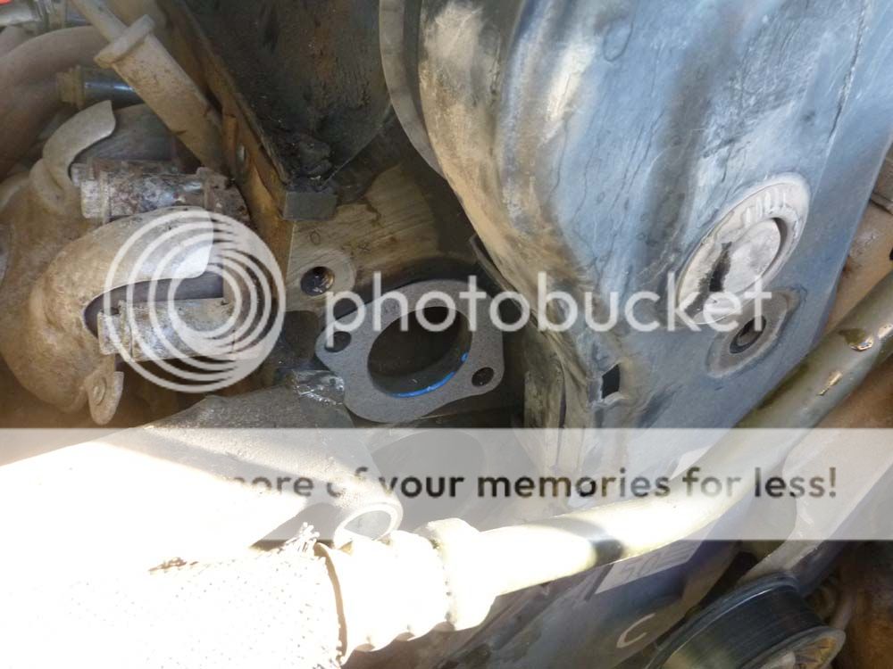

Now to install the new thermostat. The old one pops right out and the new one pops right in, simple:
I used blue RTV to create a seal between the gasket and block. It also helps to hold the gasket in place:
Apply RTV to the area of the thermostat housing that will be in contact with the gasket. Then screw the bolts back in nice and snug.
I should note that the bolt that gave me so much trouble went in with a socket and saved me a lot of time. I cleaned the area and the bolt head up really well when I could get to it, I also think already having the socket on the bolt helped. It was still an incredibly tight fit that I had to force to work, but it worked. Those few millimeters of metal cost me probably close to two hours of time.

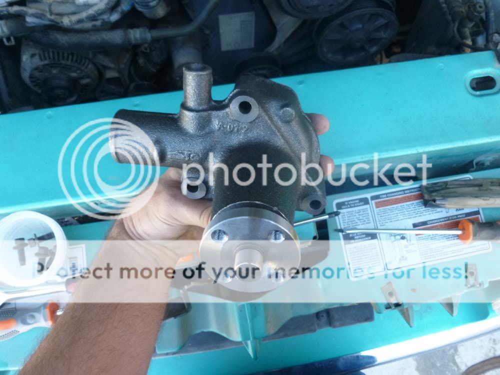

At this point I was burned out and forgot to take pictures of the water pump, but it’s the same as the thermostat. RTV around the gasket and block, then RTV again on the other side of the gasket and water pump. Tighten bolts. And here we are with both pieces put back in.
Put everything back together and fill with coolant and you’re done!
A note about cleaning the system. I took the radiator and flushed it out really well with water along with the hoses I removed. I scrubbed out as much junk as I could from the openings. Make sure you do a final flush with distilled water! Tap water can corrode the inside of your radiator with all of the minerals that are in it. Distilled water is the final flush that you want to do.
Also one final note about the leak I mentioned I noticed. It turned out that the lower radiator hose going into the water pump wasn’t tight enough. Thankfully I had just enough space to cram my hand into the area and was able to get a socket on the clamp bolt. A socket wrench wouldn’t fid though so I figured this out:
I took a quarter inch hex drive that comes with my socket set. Stuck a socket on the end and used the closed end of a wrench to tighten. I had to make a bunch of micro turns but I didn’t have to take anything apart and all was well.
