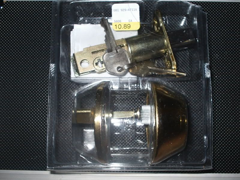

One way around this is to make your own practice lock form a common house hold dead bolt found at any hardware store and many department stores.  This is a five pin lock that can be picked up fr as little as $10.

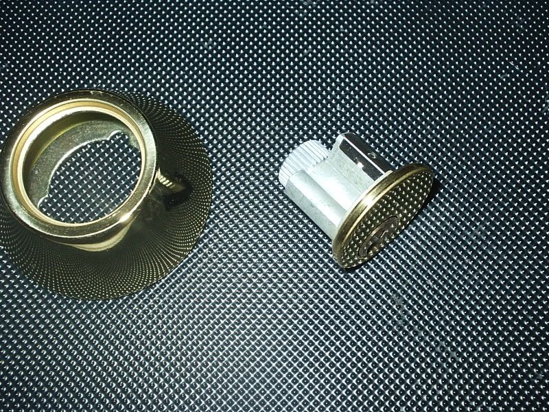

After removing dead bolt assembly the lock mechanism can easily be removed from its bezel. You now have your 5 pin practice lock.

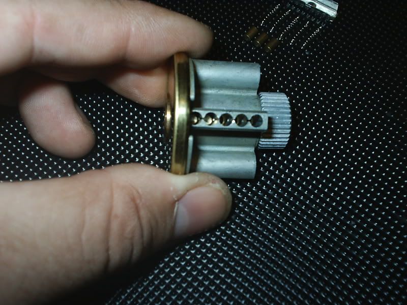

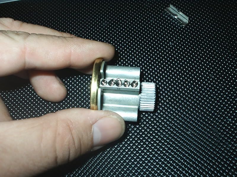

To take this further you can remove the top plate of the lock and expose the springs and pins.  This will make it clear how the lock works , if there is any question at this point.  The lock can the be reassembled with three, four or all five pins in any order that you want. This will allow you to practice at whatever level you wish

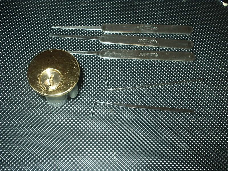

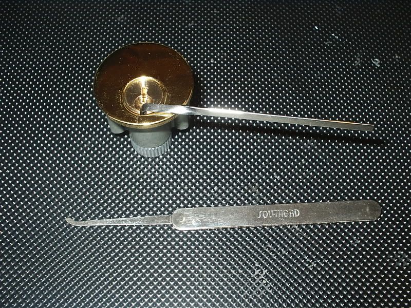

This is a basic pick set and torque (tension) wrenches
Place the torque wrench and the bottom of the key slot and provide light clockwise torque.  It takes practice to know how much torque to apply.
The pick is then inserted to the back and worked to the front manipulating the pins along the way.
