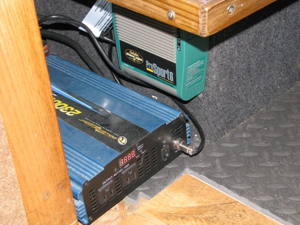

Offline statesofmind
  • Posts: 238
Re: Bug Out Bus???
« Reply #103 on: February 28, 2012, 06:20:49 PM »
Right now the engine batteries (2) are the only ones getting charged from the alternator.  I will probably hook up a three way switch that gives me the option of charging house or engine or house + engine batteries from the alternator.  I don't think that presents any issues with the deep cycle batteries.   Thanks for the kind words, helps to keep me motivated.
I just installed the new wood stove, tile base and half the flooring in. I'll get some pics up soon.

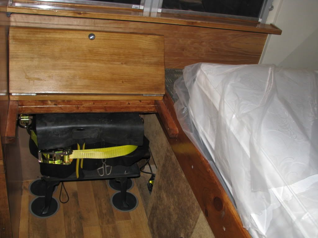

Here's a few pics to catch up on my progress.  I built a small desk area in the rear cabin area.  Nothing special but efficient and useful.
I picked up a small used Jotul 602.  One of the best small stoves made in many circles.  I had to cut into the sub-floor, remove the insulation board and drop in a prefabbed tile hearth pad.  I will be drilling 4 bolts through the frame under the floor to anchor it.
The stove itself will never be in place when I am on the road.  I will stow it under the desk pictured above.  I have some strong brackets that will mount to the frame under floor as well.  The stove weighs 160lbs.  I picked up some of those little pads that assist in moving heavy furniture across a hardwood floor to move it back and forth.  It's very easy to move.  I can have it set up and have a fire going in under 20 minutes.
I'm using some synthetic flooring that snaps together and is decent looking... and it was a super cheap, closeout sale item.
I will have some radiant shields for the wall and back part of the stove that allow less than 21" of clearance to that obviously flammable paneling.  I will paint it and mount the shields directly to the wall.  It should look nice and provide ample fire protection.
Next up... I picked up an old sewing machine and am going to try and make some decent curtains for bunks, master bunk area and front windows.  Fingers crossed.  It looks like I'm on track to have the interior complete by June 1.  Of course I'm certain I'll change things as I go, but at least it's ready to use.  I am putting the solar panels up this spring and planning a maiden camping trip in July.

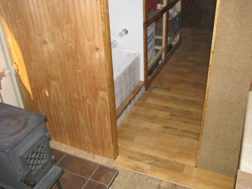

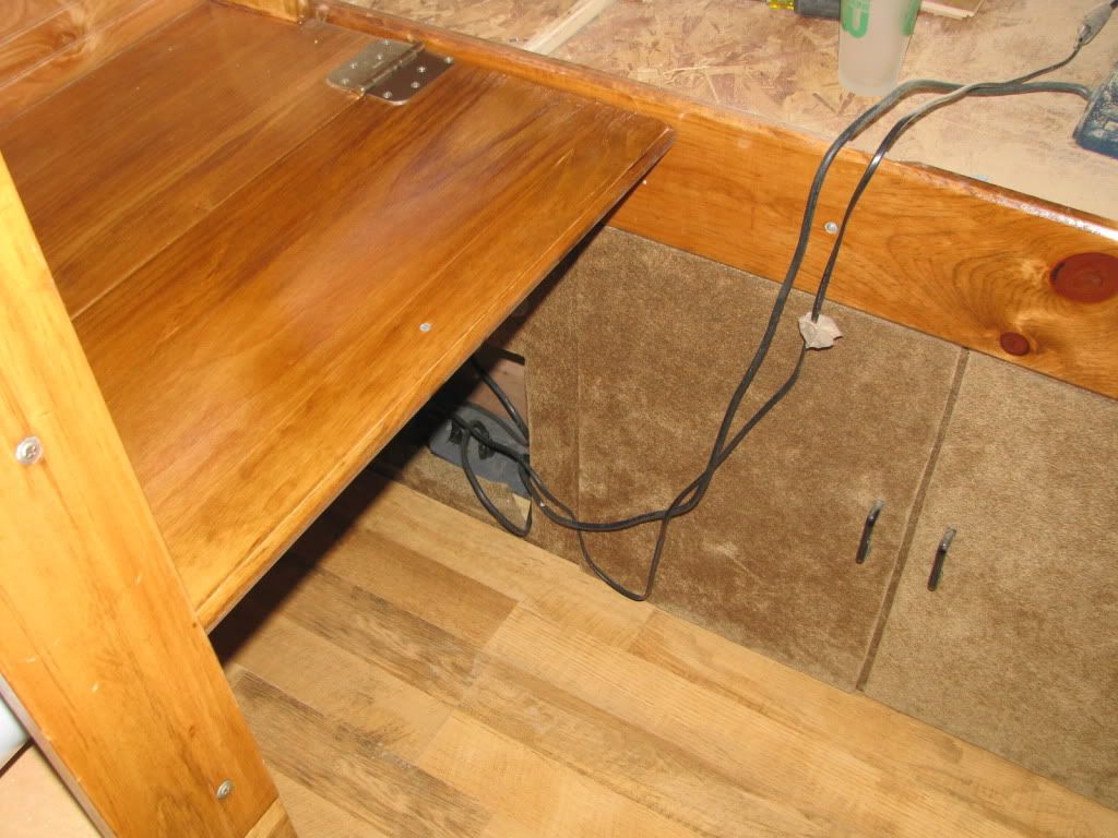

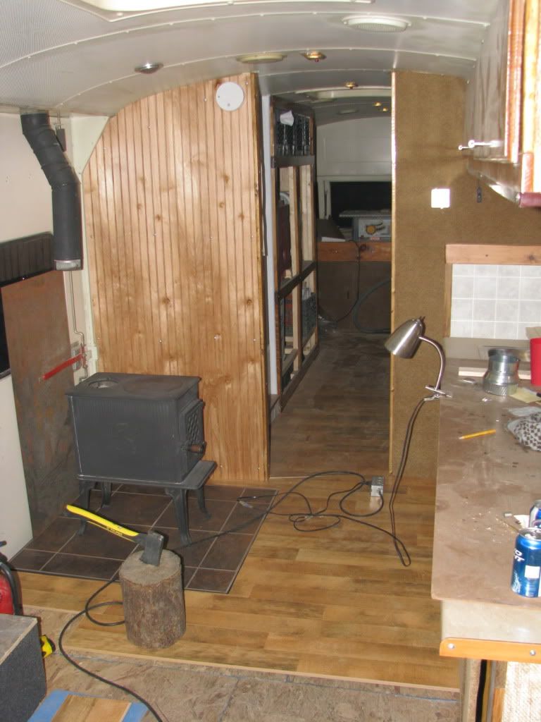

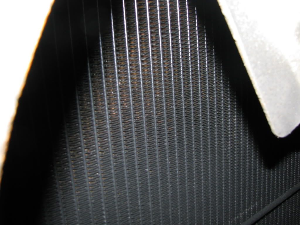

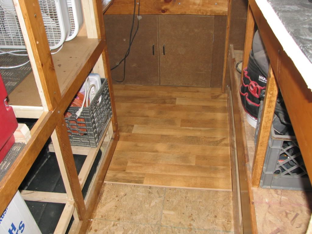

Lots of new stuff to report and a few pics as well.  First up... the flooring.  I started in the rear and worked my way forward in sections so that I can easily remove sections to get to sub-floor and front battery bank. (oops.... I just noticed I already posted a couple of these pics).

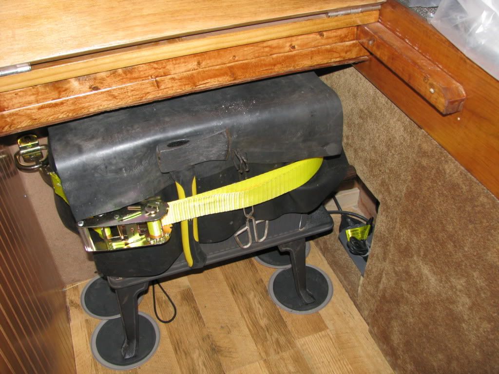

I finally got a couple pics of the travelling home for the wood stove.  Obviously I didn't want a 250 pound projectile in case of accident.  It takes me about 10 minutes to set the stove up OR take it down to travel.  It is anchored with 2 4000lb. brackets mounted to the frame and sidewall.  The straps are 3500lb rated.  This should be fine, barring any catastrophic accident... which would probably turn me into road paste anyways.
New Radiator!

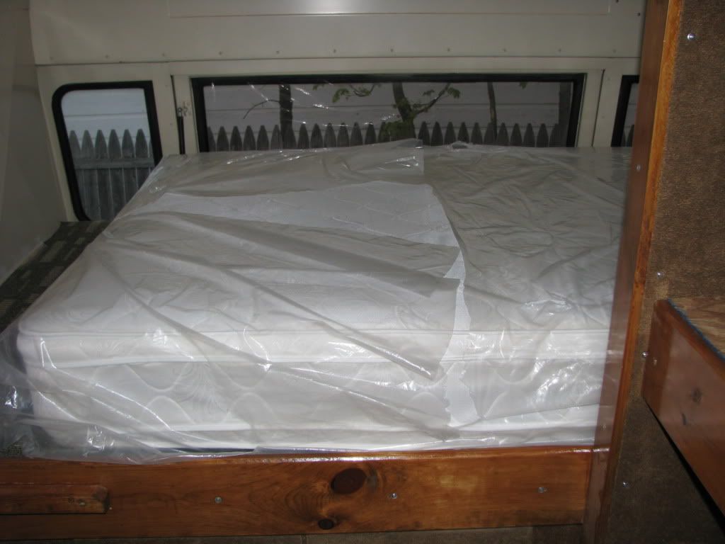

New bedding in the master bunk.

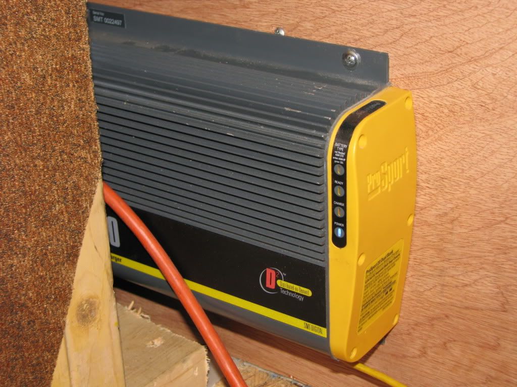

Also worked on battery chargers for when I am plugged into shore power.  1 charger (single bank) handles the front battery bank under the floor (6 batteries), the 2nd charger (dual bank) handles the engine batteries and the 2nd  bank of house batteries (4).
