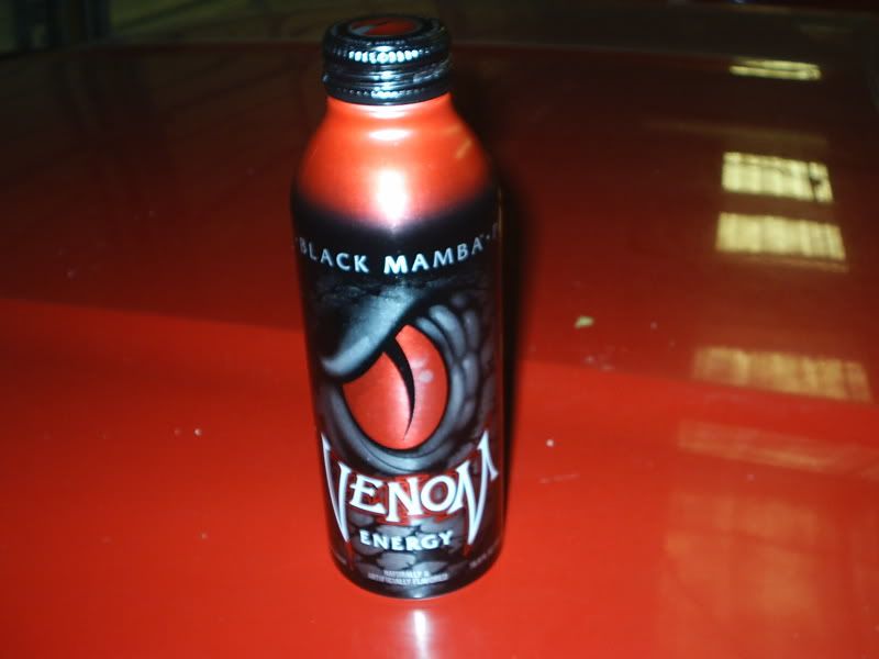

I selected the aluminum bottle from a venom energy drink. Any aluminum bottle shout work with this design, but I prefer venom. These have thicker walls than any beverage container that I have found. This make for a heavier stove than others out there, but it is much more durable. These bottles also work great as fuel containers. I chose not to remove the paint.  I kinda like the way it looks with it, but simply sand it off if you wish.

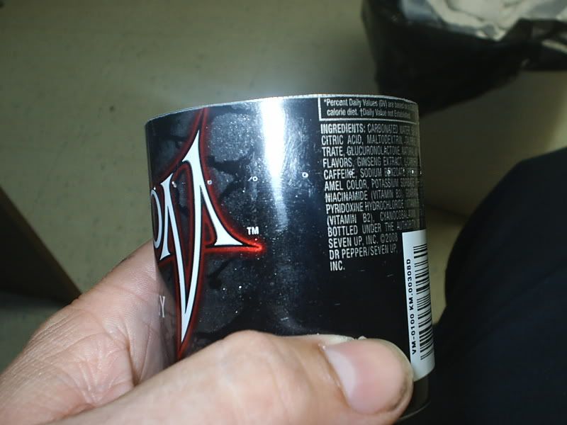

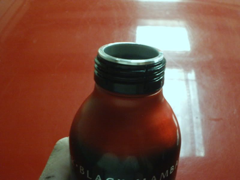

The first thing is to get rid of the plastic ring around the neck.  A dremel make quick work of this, but working without one, this is the hardest part.  If you want a smaller stove, you can cut the neck off at the bottom of the plastic ring.

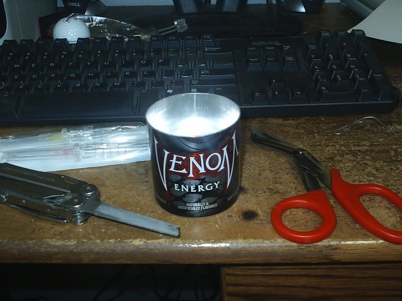

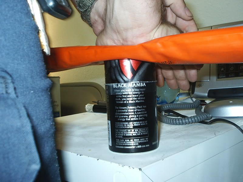

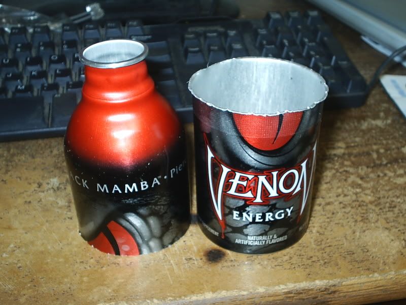

Cut the bottle in half with the top part a little longer.

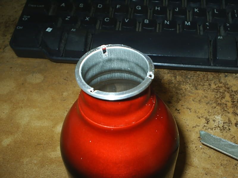

I took my Leatherman's metal saw and cut flow ports to allow the fuel to pass from the fill chamber to the pressure chamber.

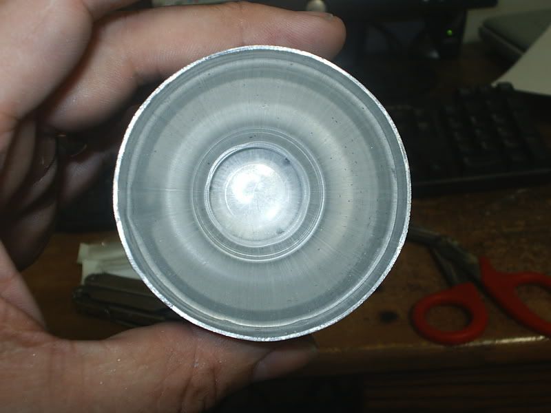

Invert the top and press into the bottom.  Being that it does have thicker walls, it is a little harder, but there is almost not risk of splitting out the side. Using a board will help give you more control and protect yourself.  Press till top is seated to the bottom. i used a board splint off the ambulance.
You cannot see it in the photos, but you will be able to see and feel where the shoulder of the top ans pressed out on the bottom.  Move up about 1/4 inch and mark.  Use tape or paper to mark a level line around the bottle at this point and trim to it as flat as possible.  A saw will work, but scissors are easier to work with.  The trauma shears I used made easy work of this.  I then used the file from my leatherman to smooth and flatten the rim.
Here you can see the inside with drain ports at the bottom

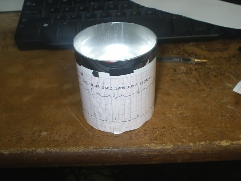

Wrap a piece of paper around the stove and mark the diameter. Decide the spacing you what for you jets and mark.  Reapply the paper and tape in place so the jets will about 1/4 inch below the shoulder mark. I had a EKG strip handy and it worked great as a template.  I place my jets at a 1 cm interval.
