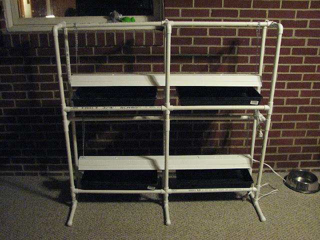

Over the past couple years I have tried starting my plants from seed.  But I always ended up with leggy, weak plants.  My problem was I was just putting them in the window.  To make matters worse, I never had South facing windows.
So this year, I decided to build myself a stand and use lights.  I like to work with PVC since it is really forgiving and easy to work with.  I found these plans and built it this weekend.  I haven't glued it up yet, I think I'll be making a couple modifications to the stand.
Anyway, here's a picture of what I built.  Total cost is about $65, that includes the 2 shop light fittings, the 4 fluorescent tubes and all the PVC.  The lights are hung by chains and can be easily adjusted to keep the lights close to the seedlings.
Helpful hint for anyone that doesn't use PVC for projects, get a set of ratcheting PVC cutting pliers.  Much easier to cut the PVC than with a hack saw, and no shavings to sand off or clean up.
Anyone have pics of their seed starting setup to share?
Yeah, it looks like yours but it hasn't been made yet.   ;D
That is really nice.  I've been wanting to buy some grow lights but that is really clever.  I have the same problems you have but you may have solved mine as well!
You don't happen to have a materials list handy do ya?

Yep, here's the parts list.
    * 6 10'lengths of ¾" PVC pipe
    * 6 ¾" PVC caps
    * 24 ¾" PVC T's
    * 6 ¾" PVC L's
    * 6 ¾" PVC 4-ways
    * Hacksaw
    * PVC cement
    * 2 48" fluorescent light fixtures and bulbs
Here's the link to the plans
One of the changes that I'm likely going to make is adding some cross bars for the seed trays to sit on.  Right now the trays are too easy to knock over.
You don't have to use grow lights for this.  But if you use standard tubes, they have to be within about 3" of the top leaves of the plants.

Good Job!  You WILL have much more success with this setup.  I had the same issue several years ago.   My setup is 4 tiers, but is the same basic setup to take advantage of 4' fluorescent lights.  I just got the cheapo ones at China Depot (standard bulbs too).  A few things that I have to recommend:
have two sets of fluor. lights at each level, and have lots of blocks of wood at various thickness so you can raise the seedlings to about 1" below the lights, and lower them as they grow.  This has produced reliable results for me for 4 years now.  The fluor. lights do give off heat, and the closer they are to the seedlings, the added heat gives the seeds a faster germination rate.  I will try to get a photo of my setup soon.

That's not something I'm going to be able to do at this point.  I'm going to try it as is this year and see how things work out.
I have 3 beds from last year.  Over the next couple weeks or so I'll be adding more raised beds.  I figure that I'll triple the number of beds this year, plus I'm going to try my hand at a three sisters garden in a non-raised bed section.

I would also agree that anyone looking at lights use a minimum of 4 tubes per level, 6 if possible.
I did two next year and it wasn't close to enough light to get anything growing.  I would consider four tubes nearly touching the plants to be the bare minimum unless you have them in front of a window.

I have tried seed starting a bunch of different ways.
I had a rack with 2 lights per shelf and it worked very well.
Think about putting some mylar (space blanket) on the back or a mirror to help contain the light and bounce it back to the plants.
The best setup I have used is a combination of all three.
A table/rack in front of the window with lights and reflective material behind the flats.
I had a timer that turned the lights off when the sun was at it's brightest in the window.
I have also done very well with a card table with 3 shop lights for about 12 hours/day
over the seedlings. Can't get any more basic than that.
