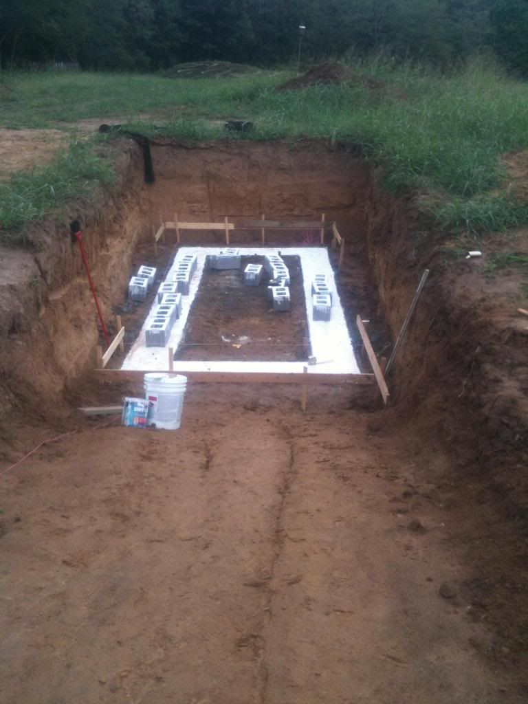

I decided that a basement/storm shelter would be a good idea, so I spent the better part of July digging.
With that done, I began digging my footings. I went ahead and insulated them to prevent condensation. This was probably the most tedious part of the whole construction process because everything had to be perfectly level and square.

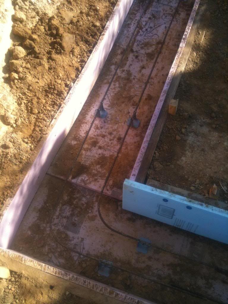

This is a closeup detail of the footing before the pour. I dug the footings below grade and used the earth as support, using gutter nails to fasten the insulation (1''). Once they were leveled, I installed my rebar.

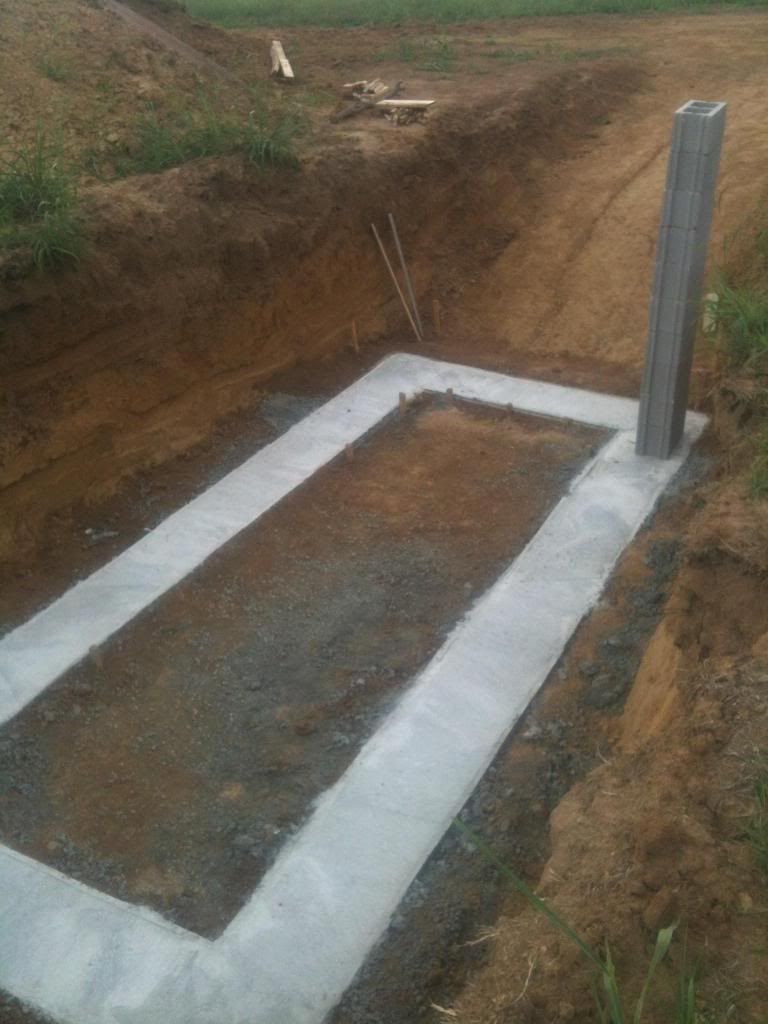

Footings poured with blocks stacked to get an idea how high I wanted to go.
After the footings cured, I sealed them (3 times) with a waterproofing latex paint called Drylok, as well as the underside of the concrete blocks. I don't want leaks!
