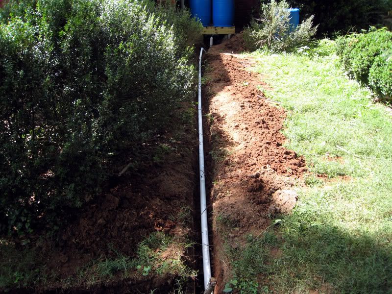

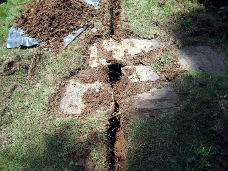

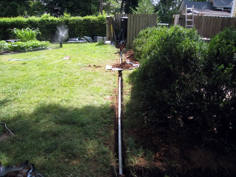

Sunday's progress on the raincatch system:
I got that damn trench finished all the way to where the 5th barrel will be. This includes getting it under the shale stone path that runs down the middle of my yard.
I've lifted some of those stones before and it is much more difficult to get them back laying correctly again, so I decided just to go under them.  The zoysia had covered them up 75% again (time to weed-whack/edge the whole walkway again before i loose them) so I ripped back the turf to the edge of the stones first.
The trenching shovel was sufficient to get under, worked it from both sides.
After i got the trench done i made the connections for the 1 1/2" pvc. I left it uncovered since I haven't run the 1/2" water service out yet; I plan on doing that one evening this week even it I don't make the connect back at the house right away.
trenching under the stone path:
From the collection point to the turn:
from the turn to the 5th barrel's future location at the fence You can see the silver queen and beans in corner of garden is to the left.  (The mist is from a cheap mist making hose fixture I picked up and use when i have to work in the direct sun on hot days- it drops the temp enough to make a difference if I place it just upwind from me.  If it is really hot and there isn't a steady breeze I put a fan behind it.)
from the 5th barrel location back to the stone path:

I decided to have the overflow at the bottom so that any water that flushes out is on a lower part of my yard and closer to the property line when it hits the ground.  Yes I have "blow holes" or breather holes in the 4 barrels that don't have the downspout intake cut into them.
I ran the overflow from the underground line for a couple of reasons.
First, it was adjustable once i got the whole system piped up:  I measured it slightly long when i glued it in. Then put some water in the system and let it settle to provide the "gravity doesn't lie" water level  I needed to make an accurate cut just below the top of the upper barrels.  Since the lower barrel was about 1.5" lower than the top 4 when all was said and done, I cut it vs the top barrel's overflow line and will put some sort of tube in the blowhole of barrel #5 that is 1.5" or slightly longer to keep it from leaking there when the system is full.
Secondly, I figured even though water will level out in this system, it doesn't take a little time for it to happen IE the water moving though the system won't be all at the same level during a downpour.  (This is just like the tide up a tidal creek being behind the tide in the ocean in the same area. ) I figured the 1.5" connector tube underground would be a better mechanism to lessen this effect vs overflows at one or more barrel tops.
Sorry for the wordy answer, hope it helps.
