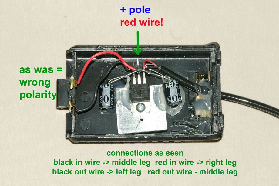

Some time ago, I bought a Baofeng Uv-5R battery eliminator.
When I got it, I found it to be defective, opened it up and troubleshooted it.
Here is a pic as was
So few days ago I received the parts to change the internal circuit to a DC-DC converter and add some heatsinking.
The original hardware consumes 40% of the energy and transforms it to heat.
Nominal losses of these DC-DC converters is 10%. Specs
In disassembly
Cutting an opening for the converter heatsink.
Lacking any good tools I cut the window out with MANY consequitive passes of an XACTO no11 blade and a similar scalpel. …
Heatsink installed and epoxied.
I bought from ebay a piece of aluminum heatsink that had the proper dimensions to extend further a bit.
Yes, my hand slipped some times…
On the inside…
Test fitted
Assembled
While the heatsink is anodized and thus non-conductive I took no chances, I installed the converter with a piece of heatsink double sided tape.
Voltage was set to 8.4V, the Real max voltage of a Baofeng battery. It is test-functioned and it works!
