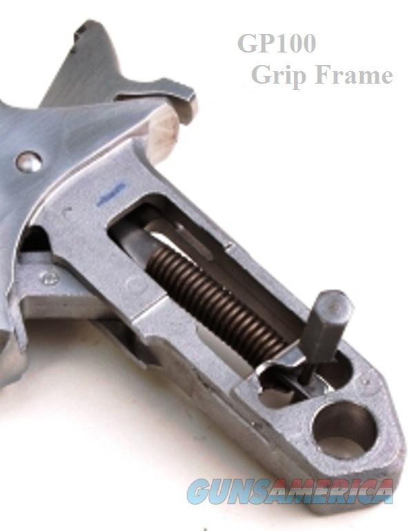

Definitely go shoot it more, and dry fire it a lot. The rugers really need to wear in. You may also be better off with a different, smaller grip. The Ruger SP and GP revolvers have more of a "stud" than a grip frame, and can be fitted with smaller stocks than a comparable S&W. It's also fairly cheap to buy a lighter mainspring(less than $10 when I last looked), which would reduce pull weight a bit. The mainspring can be something of a pain to install, especially if you have very limited hand strength. Different strengths are available, and depending on which one you used, it might cut several pounds of weight off the trigger pull. Made a huge difference on my SP101, but I also did a lot of deburring, smoothing, and polishing while I had it apart.
Here's what the Ruger looks like with the grip off. The grip is held on by a single screw from the bottom. The coil mainspring is easy to see.
