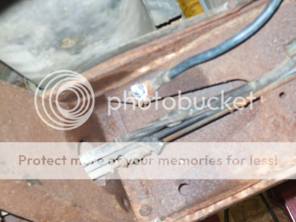

I saw a spark when the e-brake handle made contact with the dash. Hmm I thought. Checked around and couldnt find a ground wire between the body and the frame. I guess all the rusty bolts holding the frame to the body arent doing it so I connected the two with a 12 gauge cable. I also found the ground stud where the battery cable was attached at the frame was majorly rusted and probably wasnt letting in much current. I cleaned the area with a wire brush, added a bumpy washer and a new bolt. No more spark and the starter turns over much faster.

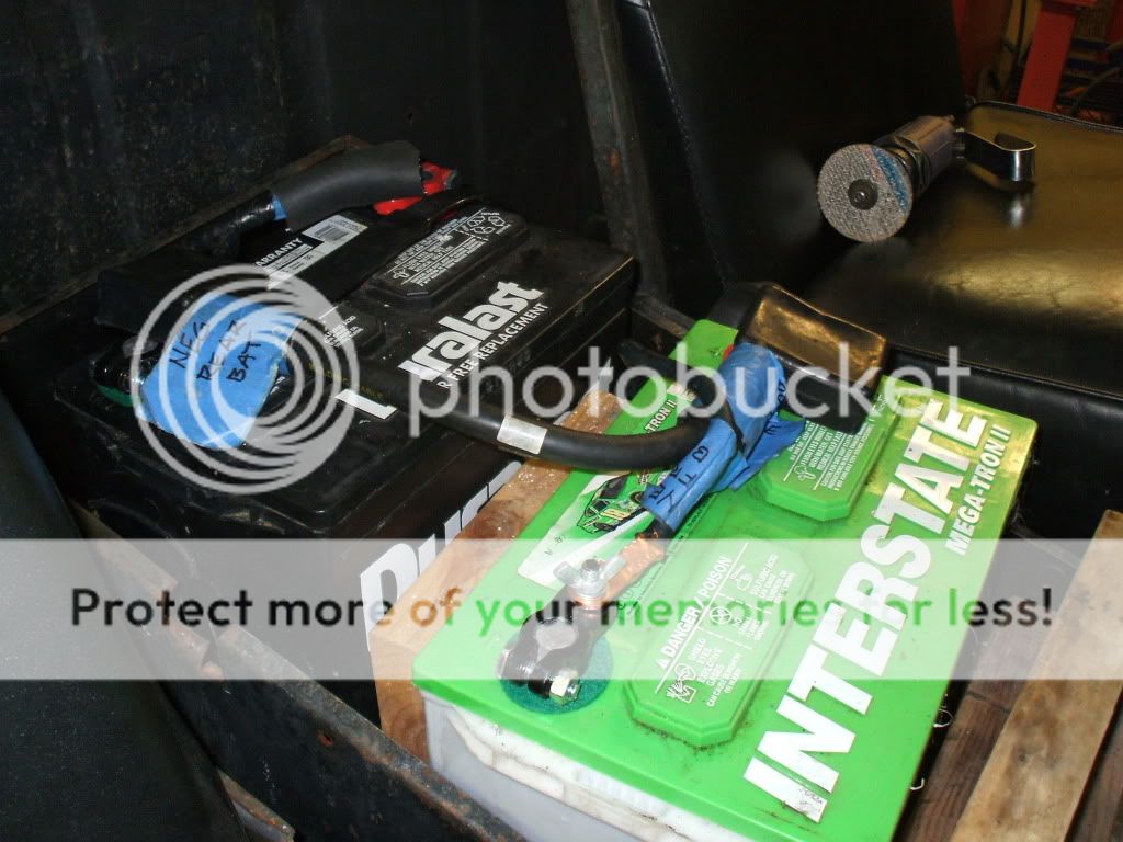

Also the battery connectors were shot and no matter how tight you cranked down on them they would still wiggle if you pulled on them. Installed marine grade clamps with a mounting stud for the cable.

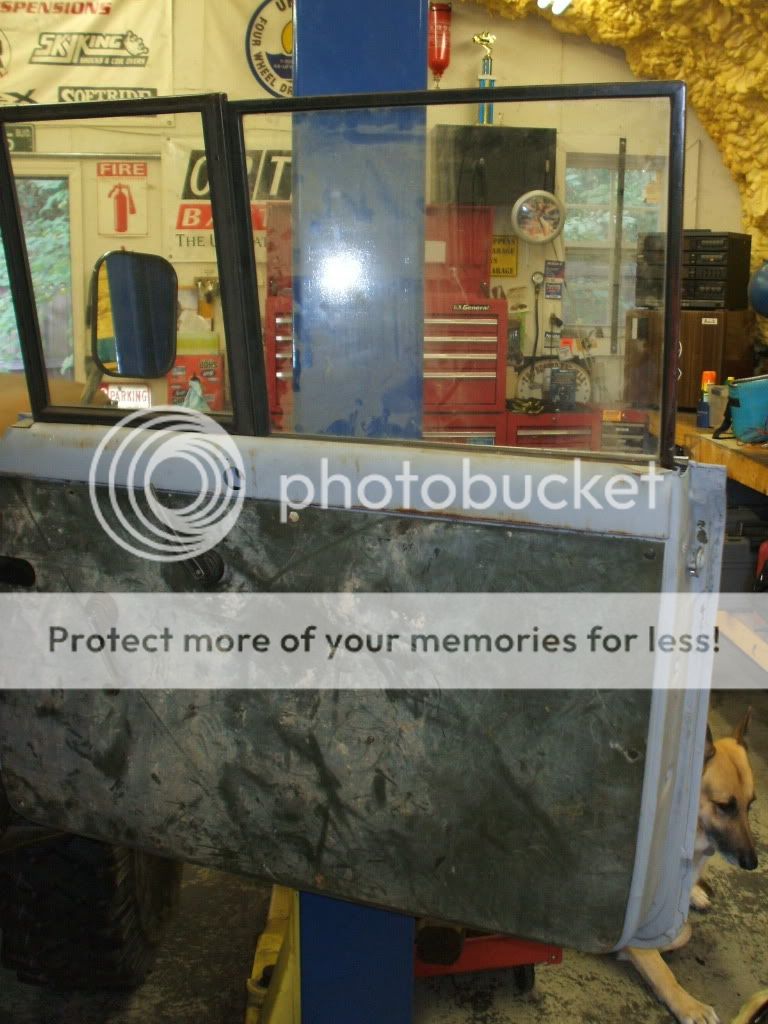

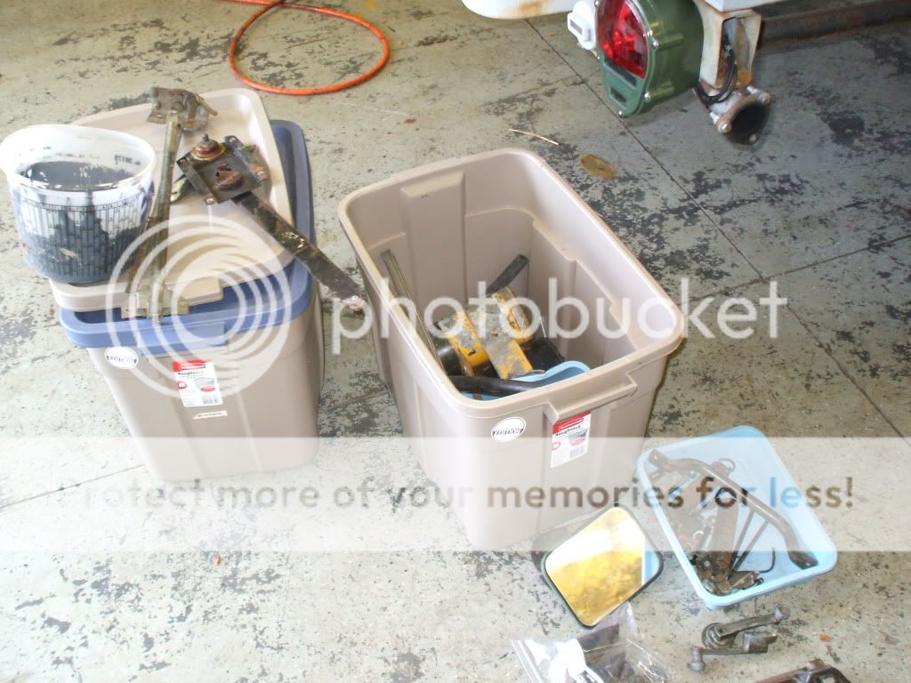

Got the window weather stripping installed and the windows. Of course the little clips that hold the window regulator stud into the window bracket were gone. I tried using a snap ring and also a washer and a serrated cotter pin but both failed when trying to roll the window up. I resorted to removing the regulators and grinding off the little stud and then installing a 5/16 1" bolt into the hole and welding the head of the nut to the regulator arm. I was able to washer and nylock nut the bolt and both regulators work great.
