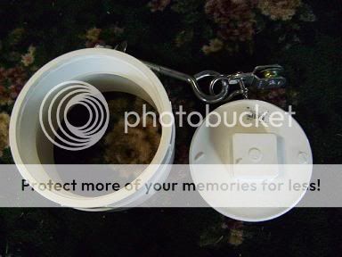

Materials:
If your well is 6 inch diameter you will need 4inch diameter PVC pipe approx. *14-18inches long depending on how much water you want to pull up out of the well.
Preferably what they refer to as Schedule 40 pressure PVC pipe. A seal pressure cap will be added to the end.
Also you will need an approx. 2 inch long 1/4 inch screws well as a 1/4 inch washer and a captive nut to attach the silicone "foot valve" in the bottom of the bucket.

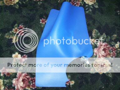

A silicon material that is cut from a kitchen use heat pad/pot holder was used to make the foot valve.
You'll probably need a 5x5 piece of material about 1/8 inch thick to shape into the valve.
THIS IS THE KITCHEN MAT MATERIAL WE USED:

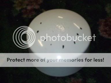

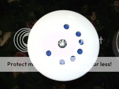

Take your end cap and mark a drill pattern for holes going around about 2/3 of the diameter:
Then drill your holes in the cap.

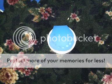

Remove the 5x5 piece of material from the pad, and lay the material over the top of the cap using the holes as a pattern.

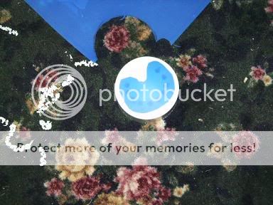

Then cut a rough shape "V" in the top of the silicone material making a rough heart shape. Shape up the material so it comes out into a rounded out shape that will fit inside the base of the cap.
The "V" has to be cut into the material to allow the material to seal inside the concave shape of the cap.
Then drill one hole dead center of the base cap in order to mount the "foot valve" inside the cap with the screw.

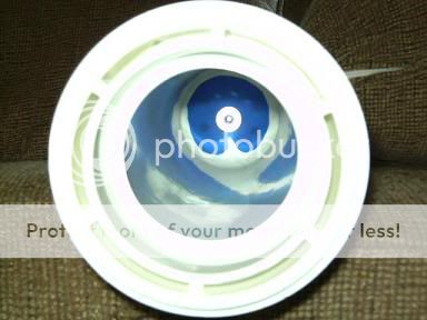

Put the silicone flapper "Foot valve" inside the cap. Run the screw up through the cap with the screw head on the outside of the cap,then place the washer and the nut like so:
Keep in mind to keep everything lined up because once this is all put together, you can't reach this stuff anymore.
Also do not over tighten the nut because it will make the washer cut into the silicone causing leakage.
Once you've got the valve installed use a large bowl of water to submerge most of the valve to ensure that you have proper flow into the bottom. Then lift it up and out to make sure that it seals up as well.
Now it's time to start assembling the body of the bucket.

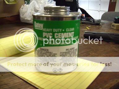

123123 used this to cement it all together:
Oatey PVC Cement.
Using the Cement apply it about 2 inches up from the bottom of the pipe and a little around the edge of the body where it makes contact.  MAKE SURE YOU DO NOT MAKE ANY CONTACT WITH THE VALVE MATERIAL.

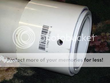

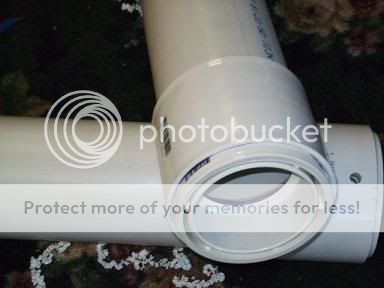

The Top Of The Bucket:
To add the top part of the bucket, We used a 4 inch diameter end-to-end PVC  connector and a 4 inch to 3 inch reducer.
Using the cement, glue the reducer to the inside of the connector and then glue the pair to the top of the pipe.
After you've done this, you'll need to add some holes to each side of the bucket so you can put a rope through.
Run your rope through the holes in the top. and you're set. All you need now is a pulley and something to mount it to.
