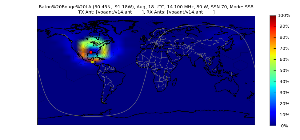

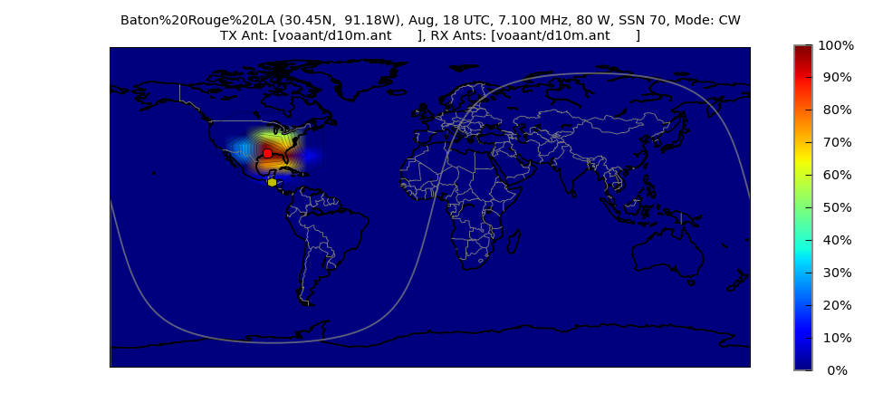

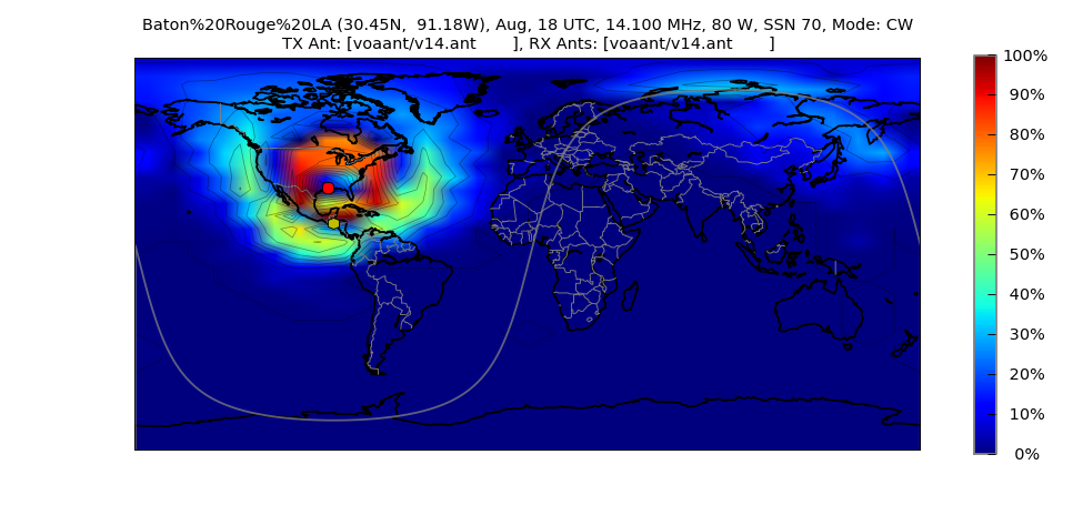

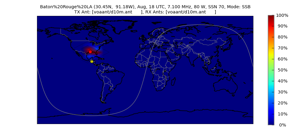

OK, here's the forecast for Sunday.  Well actually it's a broad average over what things should be doing around 1800utc for the entire month of August, but I'll take it.  Remember, it's only a rough model prediction from a freebie site (voacap.com), and conditions may be quite different on any give day.
So for the date and time on 40m:
This was modeled for dipole antenna at 10m height, which is as close as the web interface options has to an NVIS set-up  100 watts.  It's centered on Baton Rouge, but you can sort of move the coverage patch around in your mind's eye to imagine what it'd be where you are.
As a what-if, here's the same for 20m:
For this one I used the 1/4 wave vertical antenna option, since that's similar to what a steep inverted V actually is.
Looking toward future attempts, if SSB doesn't work out and people want to try PSK31 we get...
40m:
and 20m:
Looks a bit better, but not everyone's set up for it.  Still, if the ionosphere cooperates on Sunday we may have this good of propagation on SSB.
