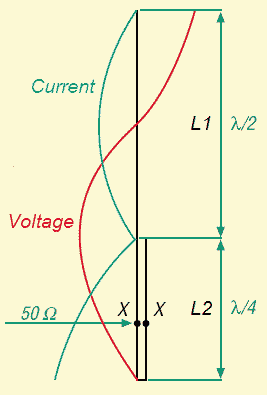

There had to be a better way, something fed from the bottom end, and good riddance to that awkward midpoint feed line.  But you can’t just feed a wire from one end, the impedance is all wrong.  Well the Germans had this same problem with their Zeppelins in World War I, and they solved it by attaching a very simple, clever matching network between the feed line and an end-fed wire antenna.  Here’s the general idea:
BTW, that’s from the Wikipedia article, http://en.wikipedia.org/wiki/J-pole_antenna .  That 1/4-wave U-shaped bottom is called a tuning stub.  It matches the impedance of the coax cable (50 Ohms) to the end of the 1/2 -wavelength wire business end of the antenna.  And yes, it really is shorted across the bottom. But it’s a DC short, RF currents don’t quite see things the same way.

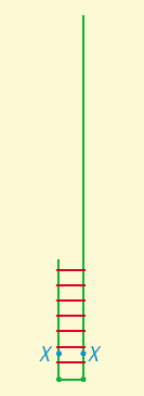

Borrowing again from that site, here’s another layout figure:
You can see the wire antenna sticking out of the top, the ladder-line tuning stub at the bottom, and the XX points where the feed line attaches.

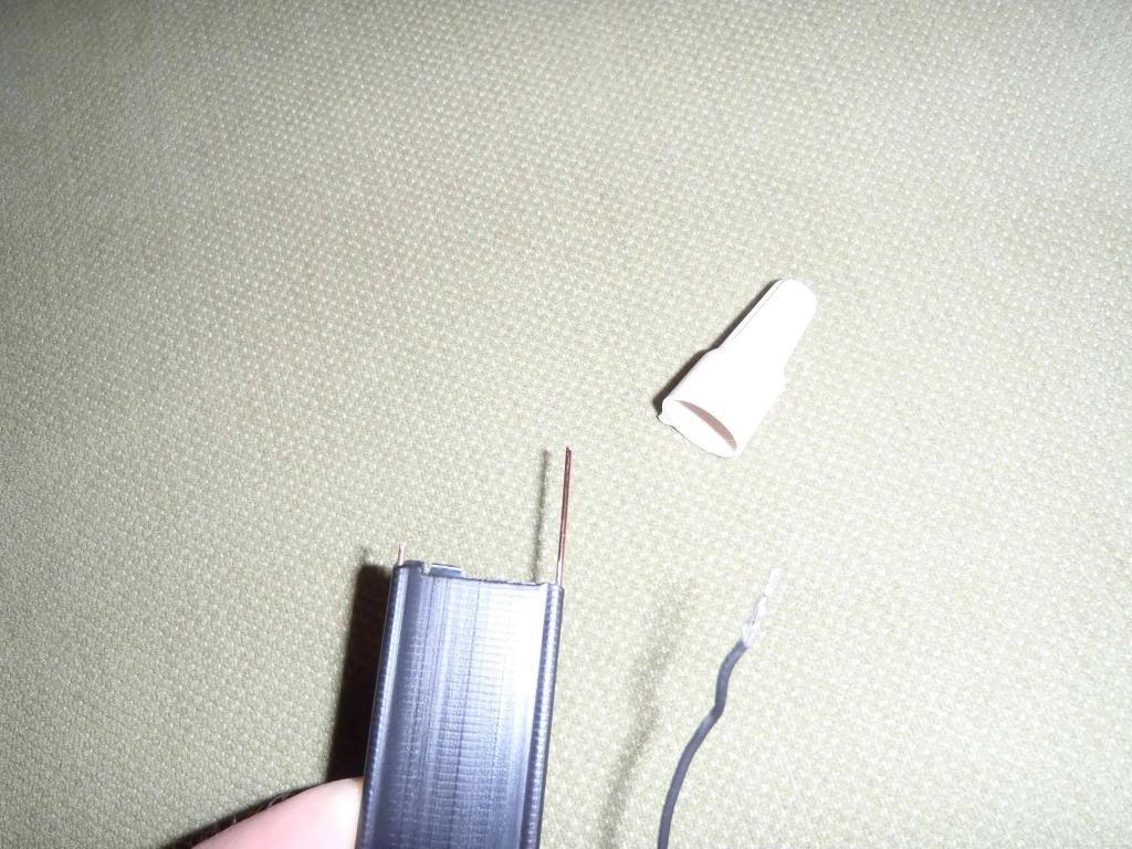

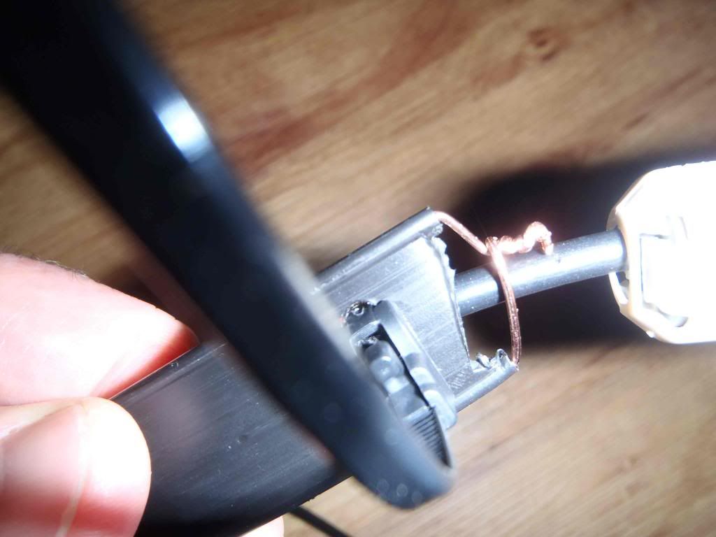

(7)Attach the antenna wire to the single leg on the ladder line, with the wire nut or any other way you wish.  You may need to trim back some of the ladder line’s center insulation, as seen in the pic.

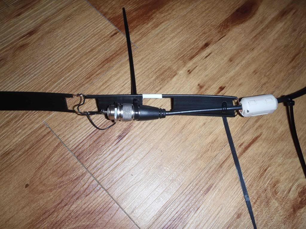

Here a picture of the main part all completed:
Done!  Well, almost.  Arrange for a piece of paracord to drape over a convenient limb, 20’ or higher, in your yard.  Attach the coax to the antenna’s connector, and zip-tie it down to the ladder line, keeping it centered on those holes you drilled earlier.  Clip on the RFI choke just below the antenna; you may need a zip-tie to keep it from sliding down (mine did).  Hoist the antenna.  If you can’t get all of the stub off of the ground, stretch it out horizontally well above the ground.  It’s not critical, but don’t leave it laying on the ground.  (This may involve paracord, duct tape, and/or strong language.)  Try to get the main antenna wire vertical.
If you couldn’t find an RFI choke, wrap a few turns of the coax around something like a piece of 3” PVC pipe or a peanut butter jar, just below the bottom of the stub, and tape them down to keep it all from moving.  Either of these methods will keep RF power from creeping back down the feed line.  It’s not enough energy to worry about for cooking you, but it can affect tuning.  Stopping it at the bottom of the antenna keeps things consistent, no matter which way your coax cable is flopping around.
